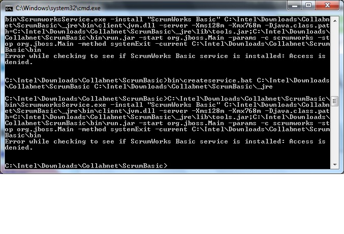

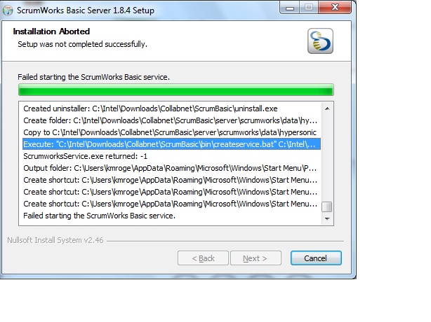

Hi kmroge,
Do you have any details on what has gone wrong? Any error messages for example? Or the step it is failing on? -
Looks like a permissions issue? Maybe UAC interfering with the installation or the service starting up?
I don't believe I have seen anyone try installing Basic on Win 7 yet. I know I was able to get it to run on a Vista system, but I had to turn UAC off to get that to work. -
Basic is not really tested/supported on Windows 7, but I suspect this has to do with installing as an Administrator.
Try right clicking the install script and "Run as administrator". -
Thanks for your prompt support!! It was UAC problem. I have installed it successfully
